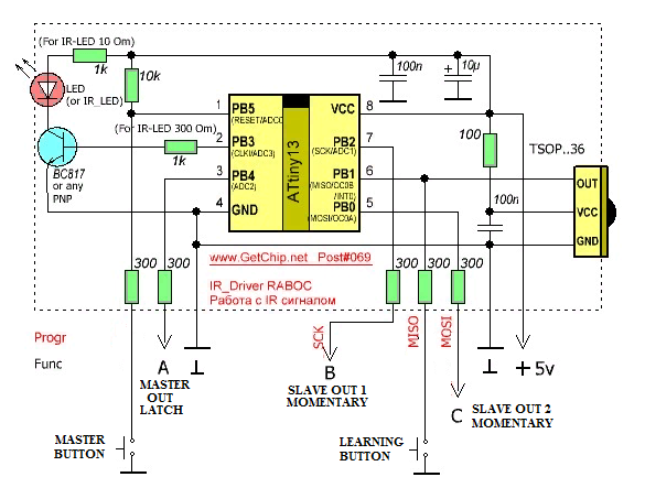

Hello.
Can You modify firmware for circuit in attachment ?
When You press first button on remote or MASTER button, Output A is active ( high ) and remains active until next press on remote or MASTER button ( something like Power ON ).
Output B and C are SLAVE. They can be controlled only if output A is active. They should be momentary. Press on remote - output active ( high ), release remote - output low.
What about fuses ? RSTDISBL should be unchecked.

T13-IR-mod1_RESET_mimi.hex [1.54 КБ]

Thanks.
I will try it.

Tested without MASTER button - works nice.
But, just a tiny modification is needed: When apply power, Output A is active ( high ). It would be much better if Output A is low when power is applied.
