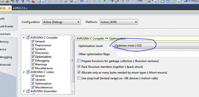

Снимок.PNG [ 52.15 КБ | Просмотров: 39326 ]

#define F_CPU 4000000
#define BUTTON_PORT PIND
#define BUTTON_1 PIND0
#define BUTTON_2 PIND1
#define BUTTON_3 PIND2
#define BUTTON_4 PIND3
#define wait _delay_ms(150)
#include <util/delay.h>
#include <avr/io.h>
void port_init(void)
DDRB=0xff;
PORTB=0x00;
DDRD=0xf0;
PORTD=0x0f;
void button1_pressed(void)
wait;
void button2_pressed(void)
wait;
void button3_pressed(void)
wait;
void button4_pressed(void)
wait;
int main(void)
port_init();
while (1)
if(!(BUTTON_PORT&_BV(BUTTON_1))) button1_pressed();
if(!(BUTTON_PORT&_BV(BUTTON_2))) button2_pressed();
if(!(BUTTON_PORT&_BV(BUTTON_3))) button3_pressed();
if(!(BUTTON_PORT&_BV(BUTTON_4))) button4_pressed();
Только у тебя он незаработает :smile: :smile: :smile: :smile: :smile: :smile: :smile: :smile: :smile: :smile: :smile: :smile: :smile: :smile: :smile: :smile: :smile: :smile: :smile: :smile: :smile: :smile: :smile: :smile: :smile: :smile: :smile:
